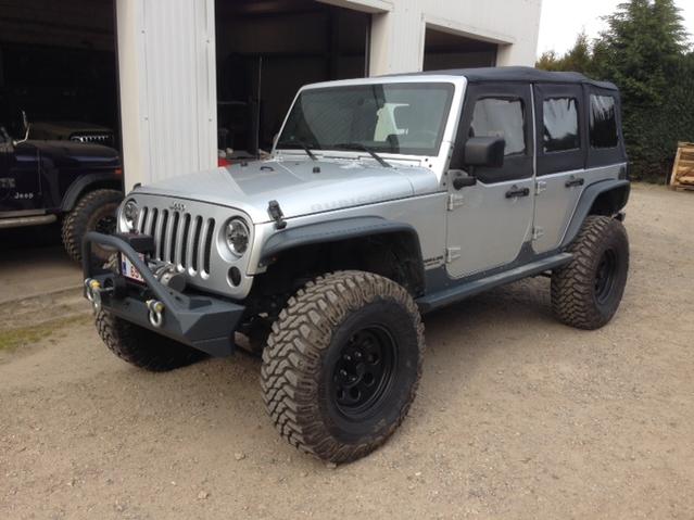

i have a 4 inch lift from old man emuClick image for larger version
