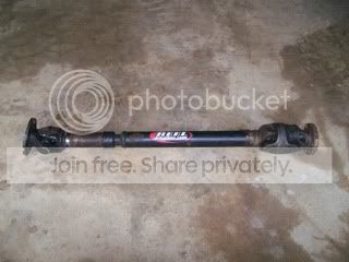

So i just removed the stock driveshaft, and noticed right away that the stock one can compress and expand really easily, however i noticed on my JE reel that it doesnt expand and contract by hand at all. IS THIS NORMAL? Are they just tight in the beginning?
This is the front driveshaft.
Please help!

Default pictures JEReel 1310HD front
here is what i have

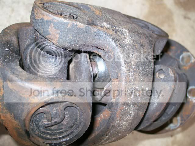

Wow that doesn't look anything like the J.E. Reels driveshaft I bought??? I expected it to look like that. Instead it looks like this:
Did you not pay extra for the rust and broken joint?
