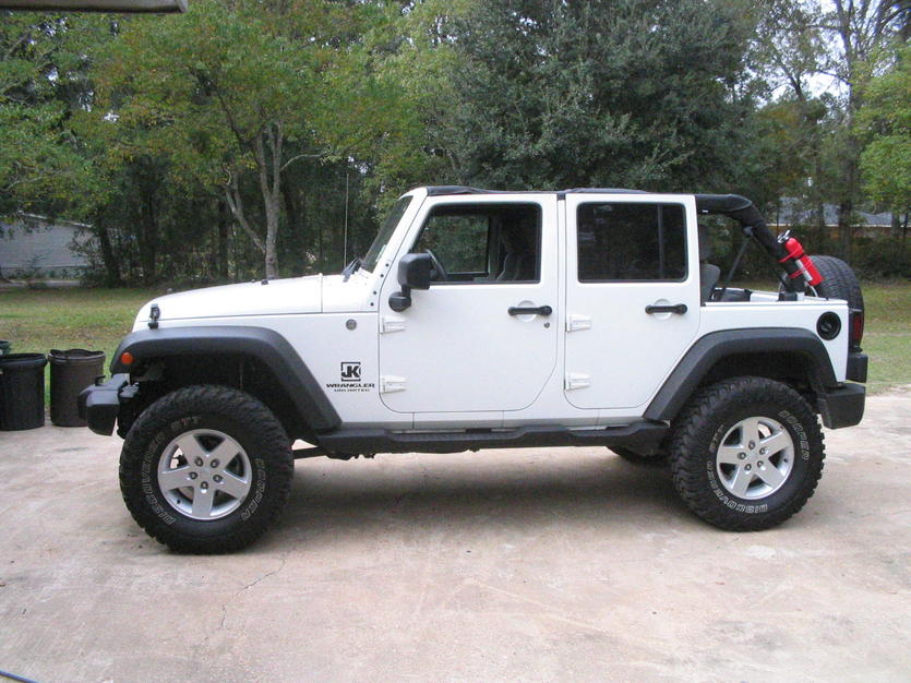

I originally ran an REbb (2.5 in frt, 1 3/4 rear) no ride change over stock, in fact a little better w/ shocks that came with it. Got 35's on it, only rubbed off road when disco'd, added a 1in body lift and cured that, apic back then.
