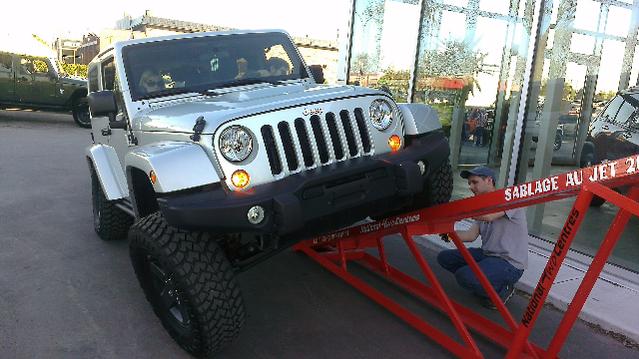

I think he means this but the opposite flex.
Attachment 475670
Nope. Look closely and you will see when the driverside tire is at full stuff the differential housing is arcing away from the transmission housing Driveshaft clearance is not an issue in this case
