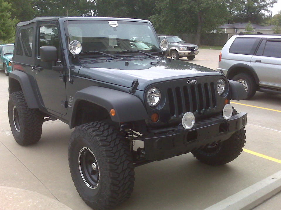

I have an 08 JK 2 door with a 5" SkyJacker lift and 35's. Since the weather has turned cold, I have been hearing a ticking noise as I gain speed through first and second gears. I asked for ideas on what this might be and was told that it was most likely the CV in the driveshaft going out due to the extreme angle created by the lift. I'm ready to buy a new shaft now, but I have no idea what I need. I have seen where several people have had luck with the cheaper options from ebay, and I have no problems with that if it's a good option. I would prefer not to spend $400 if I don't have to. I do mild wheeling, no extreme rock crawling. I do plan to run 37's in the future. I hear the terms "1310" and "1350" thrown around, but I have not clues to what this means. I assume I need to stay away from a CV style shaft, and move towards a double U joint set up, correct? What are some of you guys using? I need something that will be all inclusive and not require me to have to peice things together. PLEASE HELP!!!
