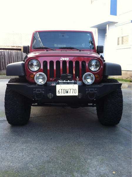

JKJody's Avatar
Posts: 654
From: Bay Area, California
Not sure if this a dot legal location?
Old Jan 18, 2013 | 02:42 PM
notsoricer's Avatar
Posts: 1,384
From: North Jersey
Originally Posted by JKJody
<img src="https://www.jk-forum.com/forums/attachment.php?attachmentid=410896"/>
That's fine as long as they aren't above your headlights and you only have 4 individual lights on at one time, no more. And get a relay for them so they run off the battery and a trigger of your choice (hi beams).
