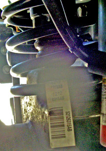

here are the pictures I was talking about will you PM me or post here the picts of your lift and front end after the lift is installed. I would like to see what bumper and winch you are carrying and what you think about all the weight on my front end?
Look in my profile and my album. The photo's in the garage are with the new winch and bumper and a 2 1/2 disk loft. It still sagged and as I described in your other thread steered heavy and rode rough. The other photo's show it with the 2 1/2" Teraflex lift and the Spiderflex spacers.
