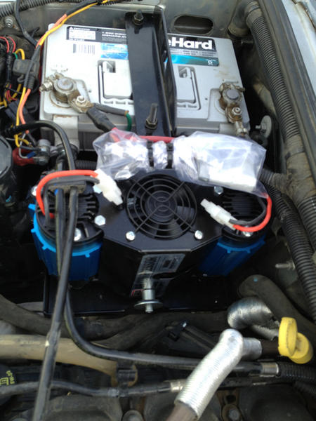

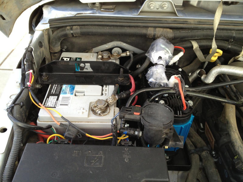

Old Jan 6, 2013 | 08:52 AM
Serg5000's Avatar
Posts: 1,309
From: Palmdale,Ca
I found a way to mount it in the engine compartment. I used a dual battery tray and mounted my compressor there. Here are some pics. I still need to wire it up but the hard part is done.
