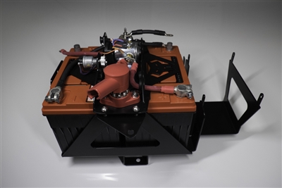

A thorough search & comparison led me to what I consider to be the best option -- the Genesis Offroad Battery Tray & Smart Isolator.
I think it's the best made. The smart battery isolator is included (even already installed and wired...).
The smart battery isolator is a solenoid, which beats the electronic ones in reliability.
Works flawlessly, and heard no complaints from others.
I use 2 Optima Yellow Tops.
Link - Genesis Offroad Jeep JK Dual Battery Kit
Name:	Genesis Offroad -- Dual Battery Kit.jpg
