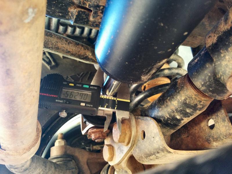

I'm with Dirtman on this. I'd just add that once the OEM does bend or fail or whatever it happens to do, replace it with a similarly priced aftermarket part. I use the Teraflex--$50 on Northridge--and it's about 50% bulkier in the shock housing and shaft. I've bent the OEM, but never a TF. Have had to replace when it eventually started leaking (but I have 137K miles on my JK). I do run it without the plastic housing because with Currie rods there's just not enough room for that extra bulk. That allows dirt to accumulate on the shaft, shortening the life of the SS. Or so the theory goes.
