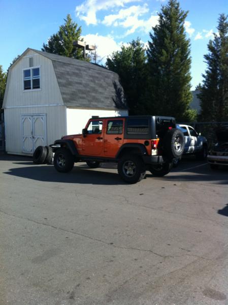

Ok, just put my AEV 3.5 lift, AEV wheels, and 315/70/17 duratracs on. I seem to have a shimmy at 55 mph that I can't get to balance. Has anyone else had this problem? I'm running 30 psi in all 4 and had an alignment done as well. Rides great up to fifty then the shimmy starts. It will also dart to the left or right for no reason depending on the road terrain. Thanks for the help.
