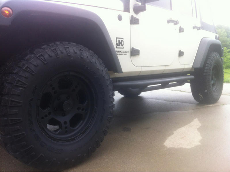

I love my Dura Tracs 315/70/17..its has a sorta aggressive look in an all terrain. It is also my daily driver. No complaints.
