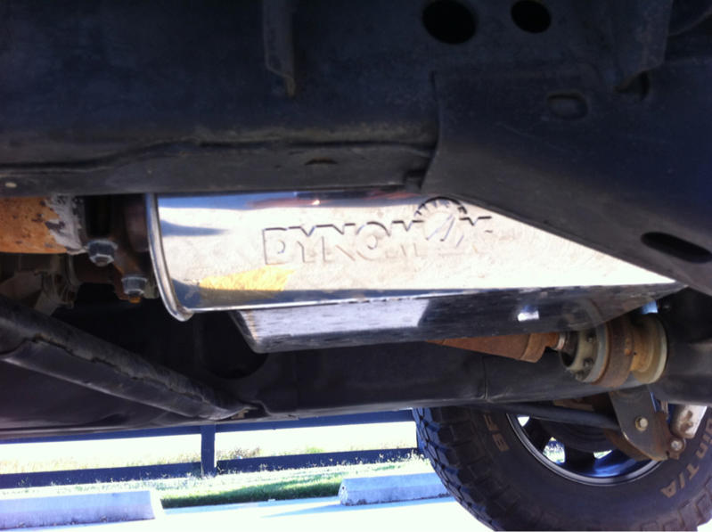

The Ugly: As a "high clearance off road exhaust" its kind of a fail.
A picture is worth 1000 words.
Its sort of hard to see what is going on here so let me explain. On the top is a Rock Rail/ Step Then you see the frame. And about 2 inches hanging down below that is the Dynomax muffler. As it is this is as high as i can tuck it up. If you push up on it the rubber flexes and it will go almost level with the frame, with the exception of the front of the muffler which hits a x member. I am going to put on the lift before i go off road next and see what i can do to tuck it up higher. If not i may end up returning it. But i dont want to as i love the sound.
Maybe i will just let it "self clearance" on the trail and see how it goes

That exhaust doesn't have to hang down that low. I got mine to hang a tad higher than the frame (better than flush). From that same shot you posted, you can't see the muffler, downpipe or anything. You can accomplish this by using shorter rubber isolators, or even by just twisting that downpipe just so it points slightly to the outside (side) of the vehicle. This forces the hanger rod to point a bit downward, pulling the whole muffler upward when installed. I'll find that pic I took of it installed and post it. Bottom line, it can be done.
And, X2 on not cutting the intermediate pipe as instructed. So glad I did the fitting first, like you.

AS mentioned you can often times get this system up a bit more, FYI.
ALSO IF YOU MADE THE CUT ON A 4 DOOR PM ME!!! WE ARE UPDATING OUR INSTALLATION INSTRUCTIONS!!!!
