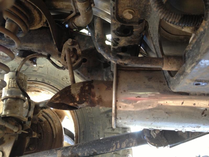

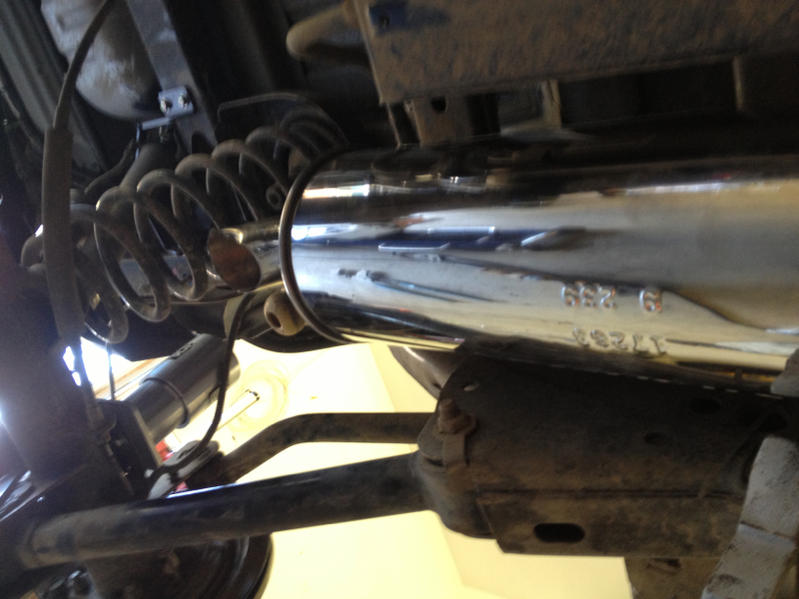

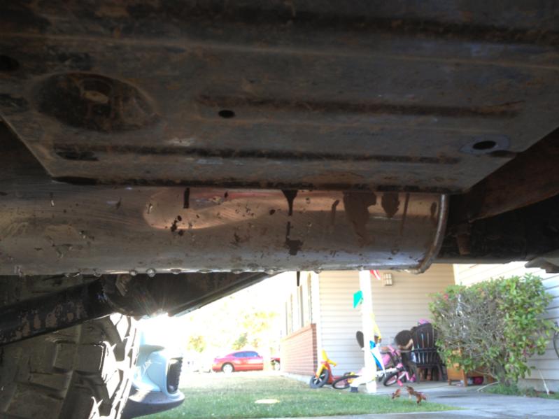

It works on a 2 door but I just bought the exhaust from Summit Racing not the complete kit. Sorry I don't have better pics to post but it looks the same as the OP's pics.

I've been running this for 2 years now. It's great, the muffler is tucked up out if the way....but I do have a few dents in it. For those people looking to run it I would suggest you only buy the muffler and just measure and cut your current exhaust to fit. It's easy and cheaper.

Originally Posted by sea bass
Would you need an additional hanger for the muffler?
On the four door you don't need any additional hangers (don't know what the 2 door looks like). The muffler sits between two hangers. You only need two exhaust clamps to attach the muffler to the exhaust pipe.
