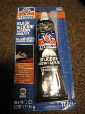

I am having issues with the electrical grommet leaking. Anyone else having this problem? What's a good solution? Thanks

Is it crunched up? Hopefully the hole isn't too large

Clean the housing and apply a little silicon?
Unfortunately, it Seems like that it was drilled a little too big.
Originally Posted by OH9JK
Clean the housing and apply a little silicon? <img src="https://www.jk-forum.com/forums/attachment.php?attachmentid=618274"/>
I bought that exact same stuff and applied it last night hopefully it will work. I'm gonna put a second coat on it today.
