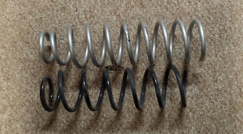

Alright, that was pretty easy actually.Click image for larger version

Measured pre-lift as shown, my clearance to the fender was 12" on the passenger side, 11 7/8" on the drivers side.
Post lift measurements are 13 3/4" on passenger side and 13 5/8 on the driver side. This was taken after a short 3 mile drive to settle everything in.
The actual spring length for my stock Rubi springs was 17 inches, the Eibach are 18 1/2. Wire diameter for the Eibach was slightly larger, with the stock spring being 13.25 mm and Eibach being 13.40 mm.
So, it looks like the Eibachs did exactly what they were supposed to do!
I'll post later on ride quality, but based on my short ride, they were a little more firm.
One question. The spring are slightly bowed to the outside of the jeep on both sides, anything to worry about?
