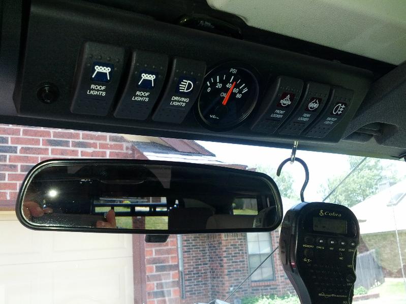

Expensive, but nice. Choose the one with a gauge opening and add an oil pressure gauge. Get dual lit switches and buy nicely printed toggles for $4 each from otrattw.com.
