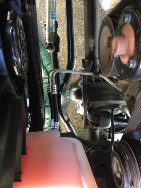

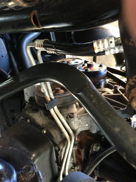

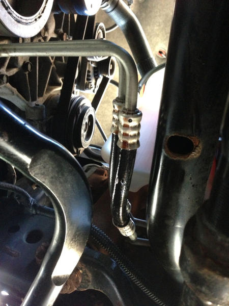

Hope it all goes well. i seem to be having a similar leak myself over the last few weeks just not nearly as bad. Not to hijack the thread here or anything, but I too thought this was engine coolant since the coolant reservoir was a bit low (still above minimum level but close to it). What do you guys think. It's coming from the two hoses that run right along one another from the radiator back into what looks like the tranny so I'd imagine it must be tranny fluid, but you tell me. It's certainly red in color.

2 hoses coming out of radiator and heading back to what looks like underside of tranny

View from the top (2 hoses just below the engine coolant reservoir)

js632 what do you think, is this what you had?

[QUOTE=JK BRO;3545693]Hope it all goes well. i seem to be having a similar leak myself over the last few weeks just not nearly as bad. Not to hijack the thread here or anything, but I too thought this was engine coolant since the coolant reservoir was a bit low (still above minimum level but close to it). What do you guys think. It's coming from the two hoses that run right along one another from the radiator back into what looks like the tranny so I'd imagine it must be tranny fluid, but you tell me. It's certainly red in color.
Attachment 455145
Your first pic looks like my 2010 looked. The lines leaking at the rubber to hard line joint should be replaced under the TSB. Ask the dealer about the TSB first.
