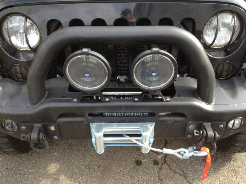

To update this, the solenoid will no fit as intended. If you don't run lights, you could probably mount it slightly higher above the winch. With lights, it won't fit. I will have to mount it elsewhere.

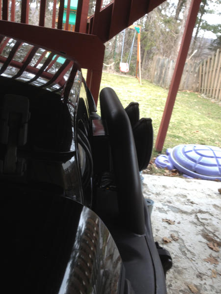

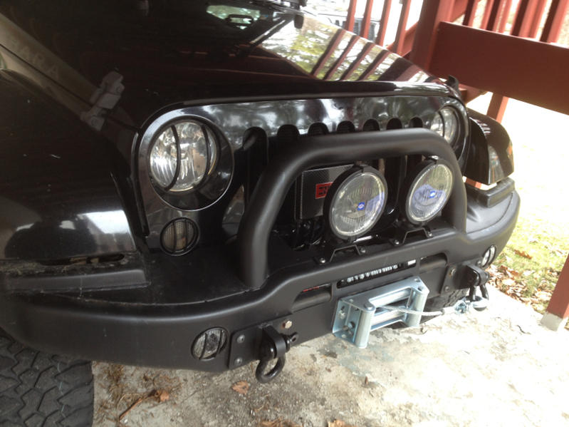

I ended up mounting the solenoid/control box vertically against the grille. I'm hoping it doesn't restrict airflow any more than my lights.

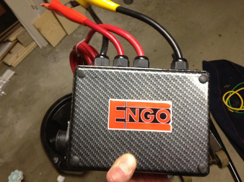

It looks like the smittybilt size and wiring is much more forgiving. The Engo box is large and the wiring is stiff.
