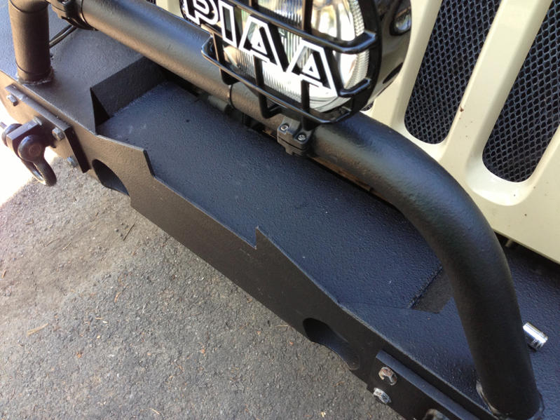

Definitely going to template the holes as I pretty much have one shot at it. I took a look at the drill bits and they are cobalt. I've attached a pic of the winch location on my bumper. The bumper is 3/16" steel. The more I post on here the more I realize how much info and variables are needed for answers. Thanks for responses so far!

I'm with the other folks who suggested caution. Did you check with the bumper manufacturer about the winch?
It's not only about the material used. It's also about welding, how it attaches to the Jeep's frame, etc.
If you finally decide to drill I also recommend you use some cutting oil to lubricate your drill bits and make their job easier and provide a better finish without destroying themselves in the process.

That's a RHF bumper right? Last time I spoke with him, he assured me it was winch ready, so you should be good to go without a plate. I've had one for a year now but still haven't installed a winch. Keep this thread updated with how it goes, I'm thinking of the same winch!
