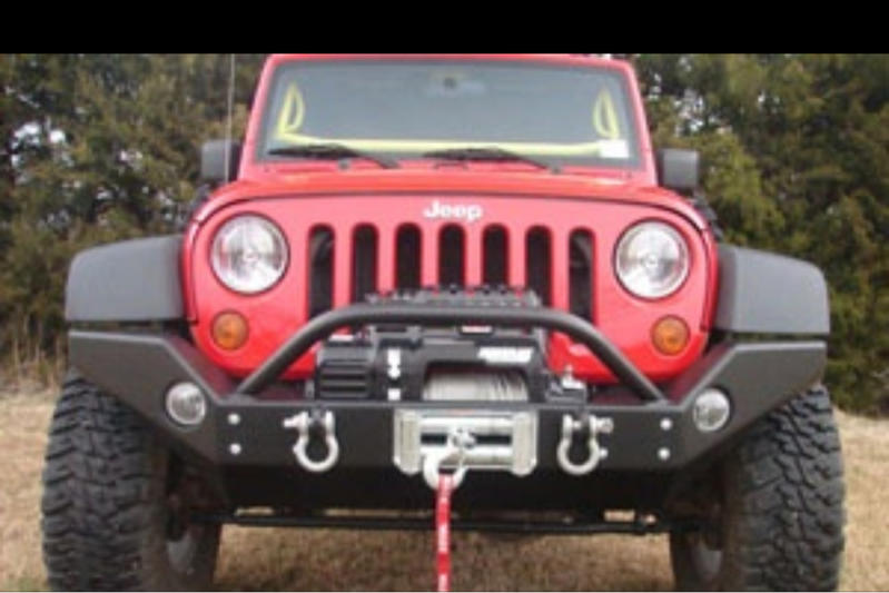

[QUOTE="White Ghost;3948033"] Dunny is right it will mount in my bumper. They said it can fix a warn powerplant in it so should I have any troubles. And I'm fine with a little noise. This is the bumper I have. Not installed yet hope in a few weeks

I have a sunken bumper. It's not the winch that doesn't fit. It's the wires exiting the rear of the solenoid box that sits on top of the winch. It's a pretty common issue. The box sits too far back and the wires run directly into the grill. In fact, if I didn't have a sunken bumper, it wouldn't be an issue as the wires could pass through the grill.
A quick google search and you can see plenty of pictures of the issue. If it's not an issue, great. If it is, use one of the aforementioned solutions.

Originally Posted by Invest2m4
I have a sunken bumper. It's not the winch that doesn't fit. It's the wires exiting the rear of the solenoid box that sits on top of the winch. It's a pretty common issue. The box sits too far back and the wires run directly into the grill. In fact, if I didn't have a sunken bumper, it wouldn't be an issue as the wires could pass through the grill. A quick google search and you can see plenty of pictures of the issue. If it's not an issue, great. If it is, use one of the aforementioned solutions.
Good to know. Thanks for the info. I'll be helping him to install so we will know to figure it out. Thanks again.
