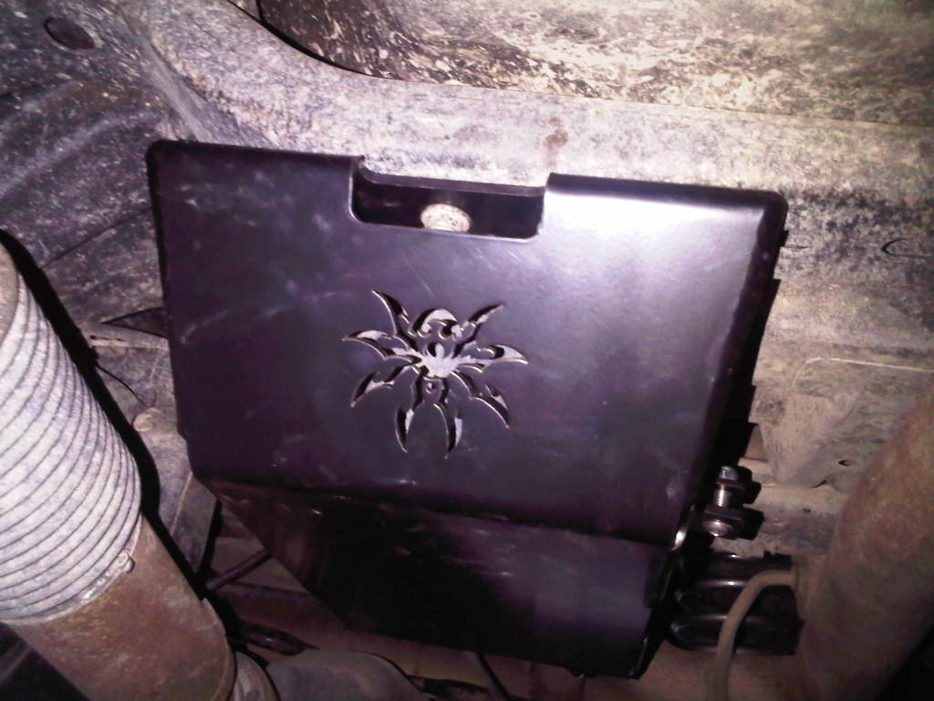

I skidded it and that was it....nice and easy no messing around.

Originally Posted by AvnxScout
I have the Poison Spyder Evap Skid. It took me about 30 minutes to install.
Ditto, and that thing feels like it could hold the weight of the Jeep, although I hope I don't have to test it. Plus it protects the evap canister on all sides.

x10! on the Poison Spyder skid. I installed mine back in July. I totally agree that it could take the weight of the Jeep. That thing is thick!!!

Poison Spyder! I'm a believer! My last wheeling adventure bent and scrapped my gas tank skid. I looked over at the poison spider and it just has some small scratches! That thing is a beast! The factory gas tank skid mean while... Looks like crap :( I'm pretty sure I'd have lost my evap canister had I not had the skid. We're talking minor scratches in 3/16" steel, after which the skid gave something like 3/4" more clearance! Yeah, evap would have been lost IMO.
