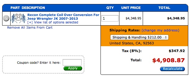

I have been looking at the Rebel kit as well and really like the setup. There is an added requirement thought to replace the rear sway bar. The kit also includes the bump stops. The added bump stops and the need to replace the sway bar put the price out of my budget. Add $212 shipping charges and $348 CA sales tax and I am almost at 5K.
Thank you California for your stupid high taxes.
Attachment 455351
When I had the rear lever installed, I kept the stock sway bar, and bump stops were included, front and rear. NorthRidge 4x4 is a distributor for Evo, so you could get your kit tax free and free shipping.
Attachment 455351
Upgrading to a rear AntiRock from Currie isn't a requirement - but is highly suggested and something you should be considering anyways if you are adding coilovers to your wishlist. The added articulation and confidence an AntiRock provides should be paired with any coilover system.
