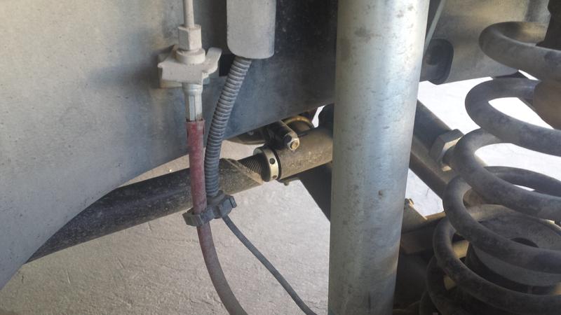

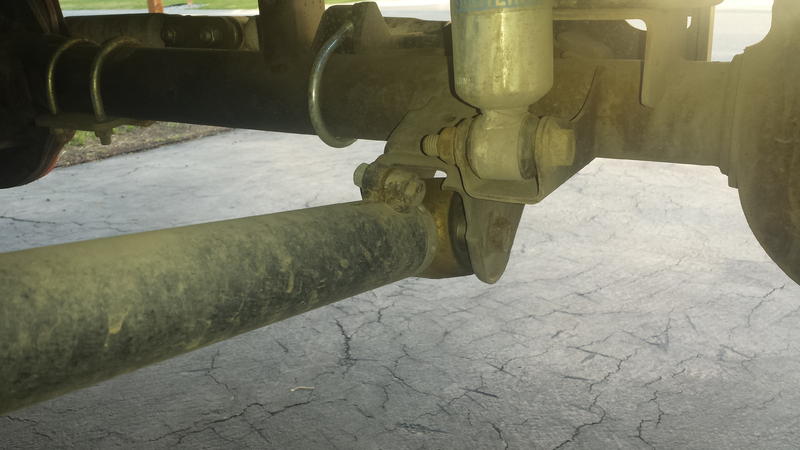

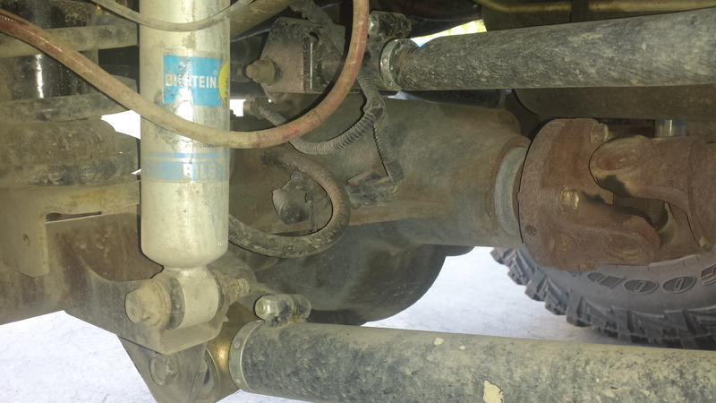

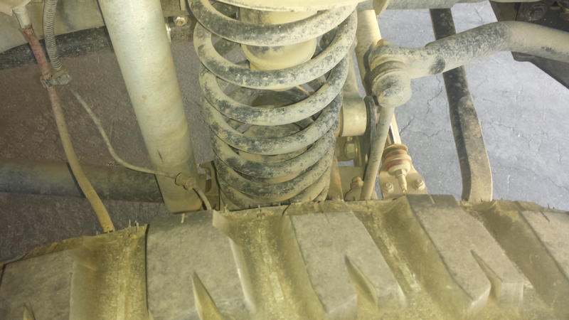

I have a stock rubicon 44. No bind in the coils, and my caster is 5.5 degrees-ish. I just took pictures.
Attachment 554500
Attachment 554501
Attachment 554502
Attachment 554503
Thank you for the pics.
