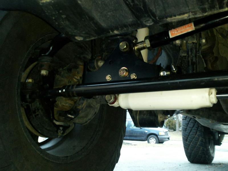

I just put mine in and it fixed everything!Click image for larger version

I was having bump steer issues leading to death wobble at low speeds when I hit potholes on gradual turns. Prior to doing this kit I tried everything. Went through planmans' entire write up. torque, changed bolts checked everything and it still persisted. put this kit on and no more problems.
As for installation issues it was pretty simple. Used a battery powered drill to drill the out for the bushing. Have an extra set of hands to feed it cutting out, will go a lot easier. There is another hole that needs to be drilled, you might need to remove the passenger side brake rotor if you don't have an angle drill.
Good luck!

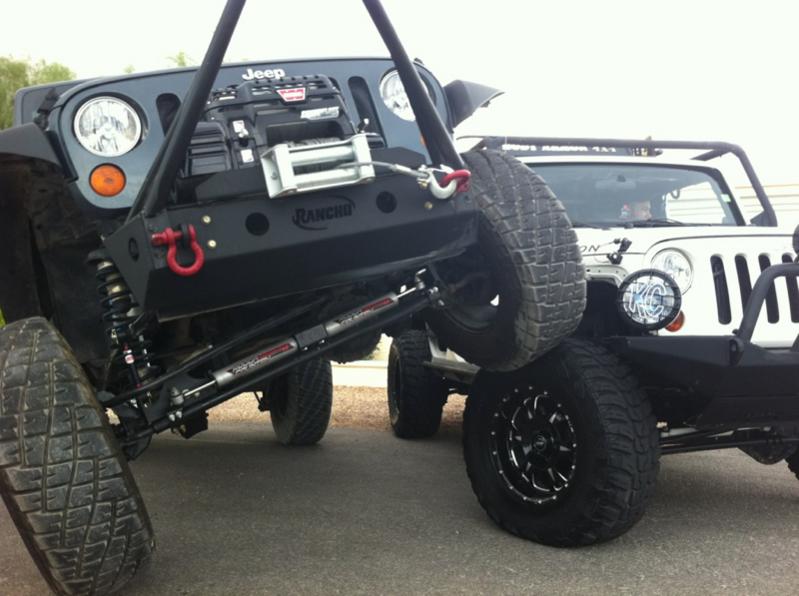

I put mine on about a year ago, it fixed the geometry once you go over 3" of lift. I'll post pics in the AM

Here's a pic for you
