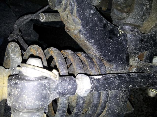

Mine hit the springs at the bottom as well. I am not concerned. It really doesn't affect the articulation of the spring nor causes any negative issues. Don't worry about it.
Do you have a pic of it hitting the spring? Just curious!
Old Jan 5, 2013 | 02:23 PM
blue project's Avatar
Posts: 1,531
From: Cape Cod
A little salt and dirt covered but you can see it.

Old Jan 5, 2013 | 04:33 PM
MangoWilly's Avatar
Posts: 290
From: thornton,co
My spring barely hits the teraflex gusset I have on mine. I've looked at it a few times and seems that there are no issues. Haven't been wheeling lately though.
