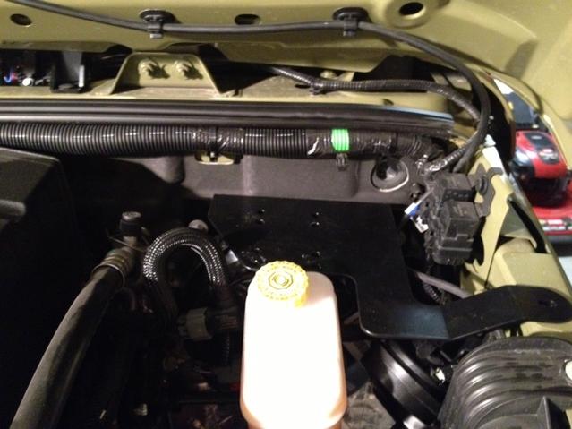

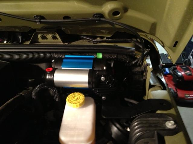

Does anyone have this setup with the ARB solenoids installed? Want to know where your mounting them. Here is mine so far.
ID:	436015Click image for larger version

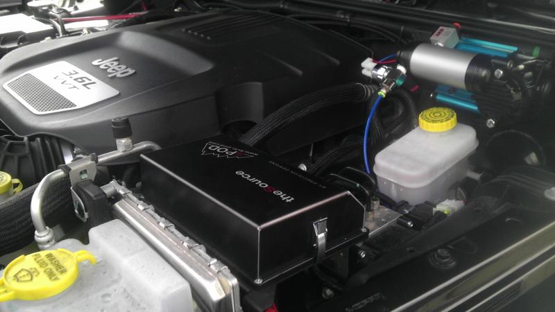

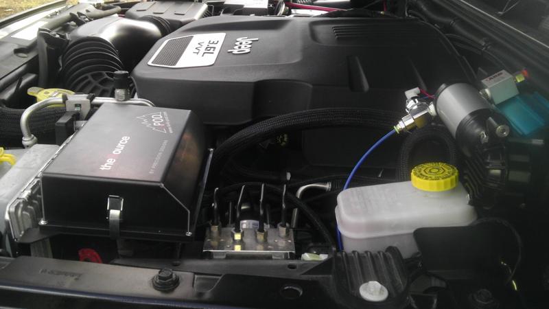

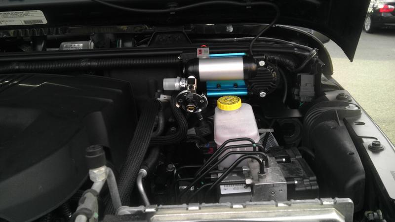

Mounted mine like this, found it was the only orientation for it to work with solenoids, air line to gauge, air hose attachment.

I was thinking about adding a manifold that runs forward and then mount my solenoids onto that and plug the rest of the holes.

Are you wanting to add another manifold for more air volume, or because you're not able to get all the solenoids and fittings oriented the way you want?
Old Mar 19, 2013 | 09:22 PM
whitedynamite's Avatar
Joined: Feb 2013
Posts: 50
From: Las Vegas, NV
I want to add it srictly for solenoid orientation. Just wondering what others have done with theirs. I think it would work if I ran that manifold forward, parallel to the brake reservoir. then mount the solenoids to the top and the quick release for the tire hose at the Fwd end.

The way I have mine oriented, the solenoids fit just fine, with the tire hose coupling, and I also added an extra tee for my air gauge. Its a tight fit, but it all works with no interference. Just play with it spinning the manifold around, etc.
