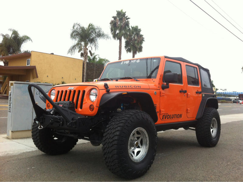

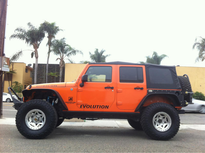

Originally Posted by inspect-a-home
Had the same issue at the rears due to my Jeep being so light..it's a simple fix, replace the 12" top spring with a 10" spring and or go with lighter springs back there. Here is how my Jeep looks after all the tuning and getting it down to 3", this is the lowest lift you could probably get with the bolt on coil overs. Setting this lift at 2.5" is nearly impossible, you'd bottom out on the bumpstops on every bump.
You can get it about that low, you just need to know how to set up the coil timing correctly.
Originally Posted by rtguy1
is the rear bolt on setup adjustable to 3.5" of lift? i have read that it can be adjusted as low as 2.5" but i met a guy running this on his 4door and he said it was adjusted as low as possible and he had around 5"+ of actual lift. he said he need to change coilovers to go any lower.
he just needs to swap out the coils on the actual coilover, very simple fix. If anyone has this issues just call us we will get it taken care of
Please give us a call, we can set you up with the correct coils the first time around
