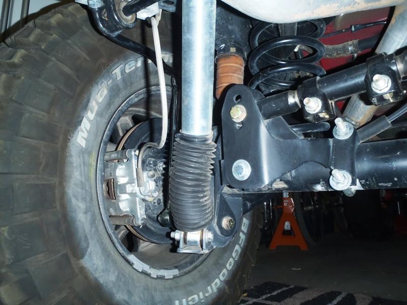

I used the synergy version on the bottom and top and kept the same bumps. So don't have to worry about the shocks bottoming out on full stuff
Name:	Poly Shock Mounts 001.jpg
