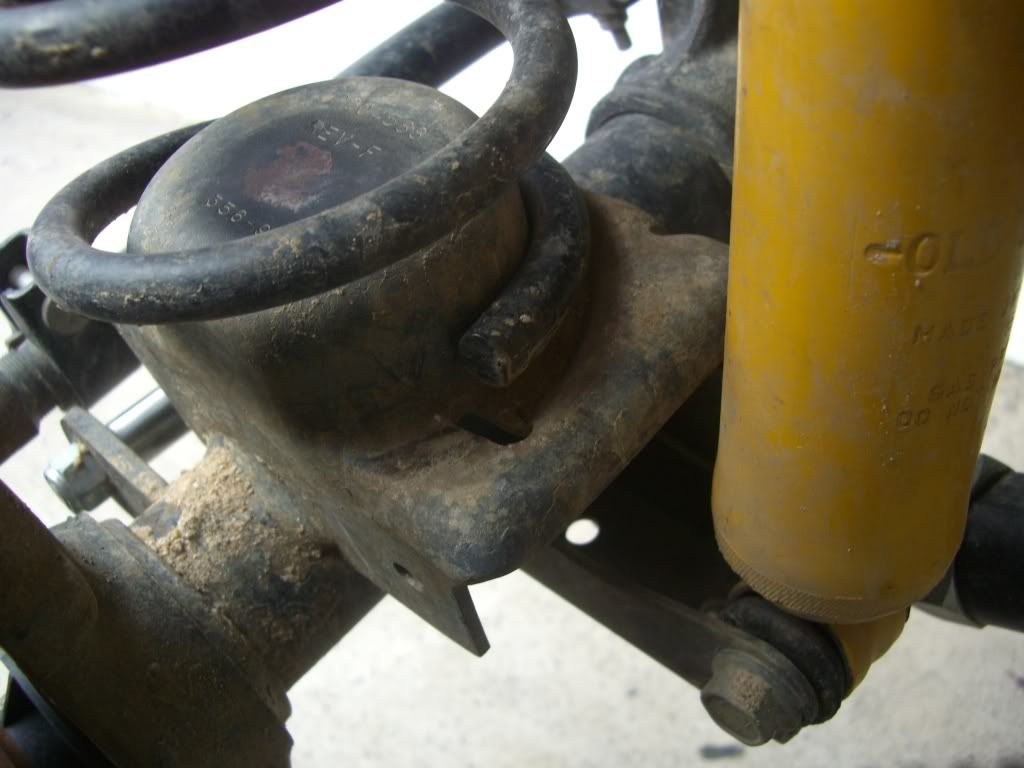

You can use this and measure so that way you'll know for sure.
