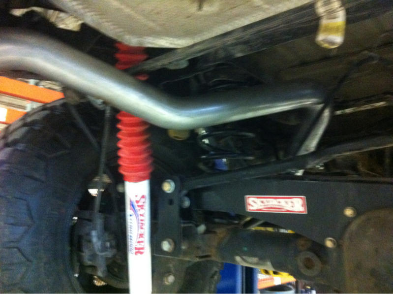

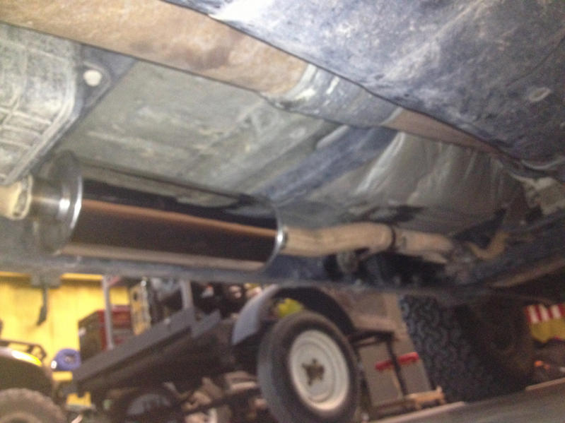

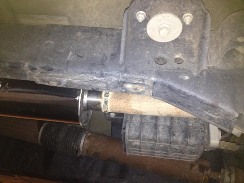

Delux2769's Avatar
Posts: 2,681
From: Quinlan, TX
I love my Dynomax exhaust tucked under my driver's seat.

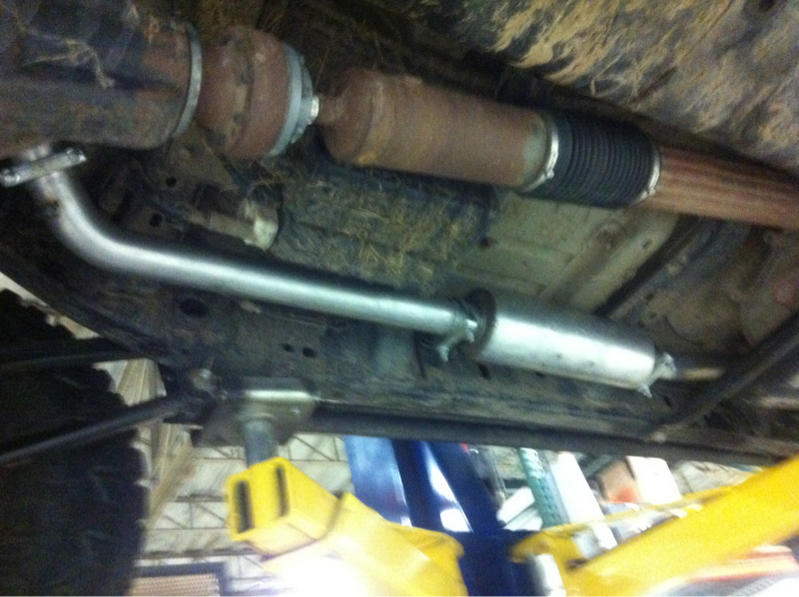

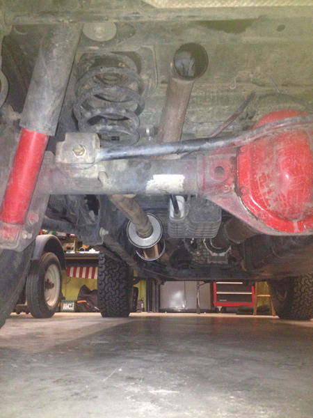

From: Grand Junction, CO
Just installed the MBRP offroad tailpipe with muffler before axle. Looks great, provides higher ground clearance and sounds awesome, not overpowering. Plenty of room on the 4 door but its recommended to relocate the evap on the 2 door
