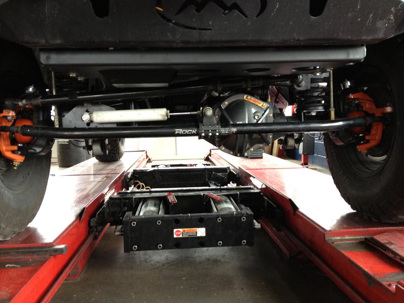

I have it. Works good. Since it uses the same bolt holes that retain the swaybar, I had to do a juggling act trying to keep the swaybar in place after it was unbolted, hold the skid in place under the swaybar, and then reinsert new longer bolts with spacers and washers into the swaybar bolt holes.

Awesome, thanks! Your pic shows that it doesn't drop down a far as I thought it would which I like too
