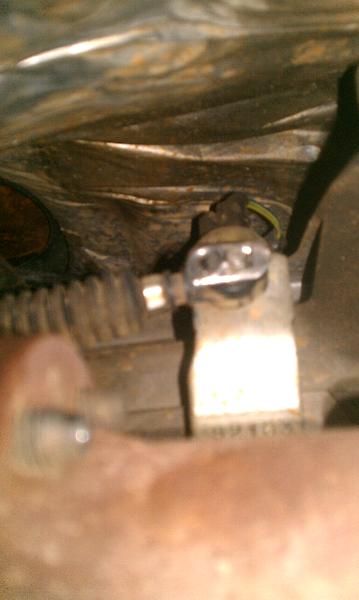

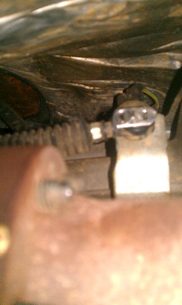

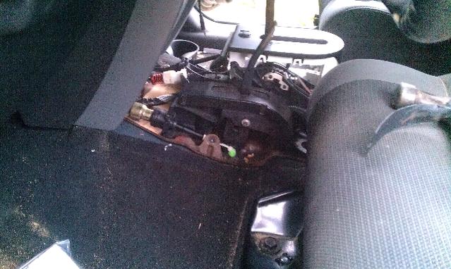

Wow, man I'm 20 now but I hope to do something like this before I thirty. What a journey that would be! Anyways i drive a 07 so I'm not sure if your year model will have the same problem but there are little plastic clips that hold the cable which, when pulled, engages the 4x4. They tend to break fairly easily and are connect to the lever under the center console and on the front of the transfer case right above where the drive shaft meets . It would be smart to invest in some or buy something like them because the clips the stealership give you are a bit difficult to put on.

Excuse the hobo fixes, its all I had on the trail haha

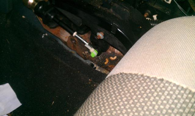

Better pic

Thank you so much. I will take it apart to see if it is the same and buy a set.
