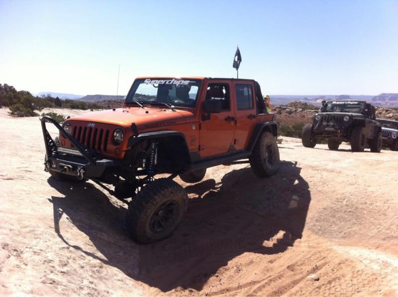

Here is evo's bolt on kit at 3" lift in front, 3.5" in rear...35" tires and nemesis flares

And the flex

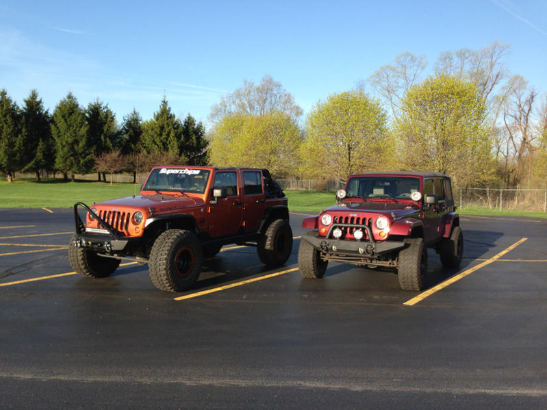

Doesn't have as smooth of ride on road as I anticipated, but it's smoother than most. Handles exceptionally well. Since then I have gone to 38's and lifted it up another inch, but barely sits higher than my buddies on 35's and 4" rancho lift:
