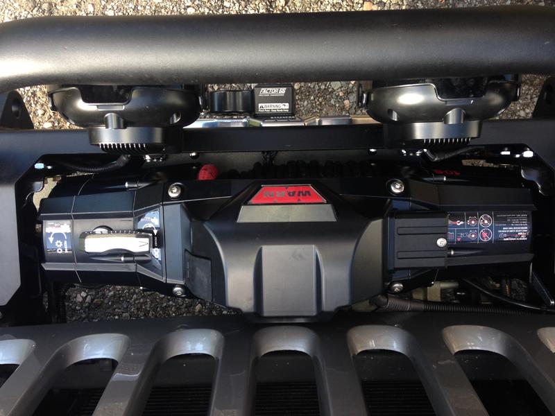

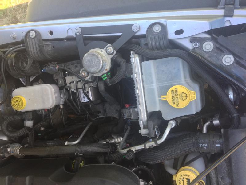

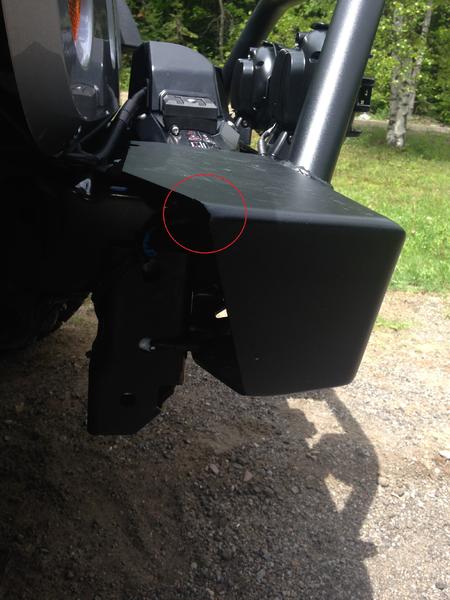

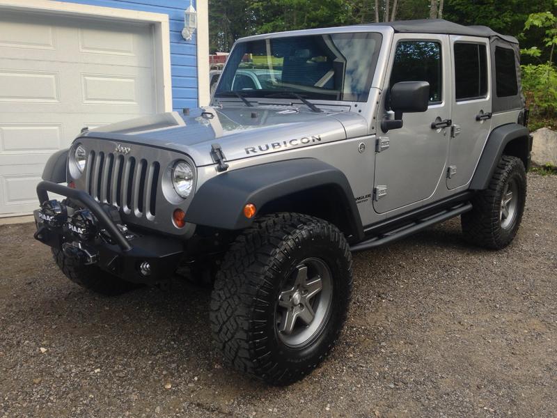

ID:	559542I just installed a new Expedition core series bumper.
So here is my overal impression of the product.
Before purchasing the product I looked at many pictures over the internet of this bumper and I did not find many reviews but most of them was relatively positive so I pulled the trigger on this bumper. I really liked the design of this bumper and all his features.
The bumper comes with a basic instruction sheet and not very detailed; instructions are very poor, you need to figure out where each bolts and nut are going by yourself but it is not difficult it is just annoying they don't provide a better plan with the bumper.
The installation is easy and the hardest part is to cut the vacuum pump bracket and relocate the vacuum pump. The bumper fits well on the oem holes location.
The brackets provided for the oem fog light are not properly bent and I did have to work them in a way to decrease the angle so the fog light fits better.

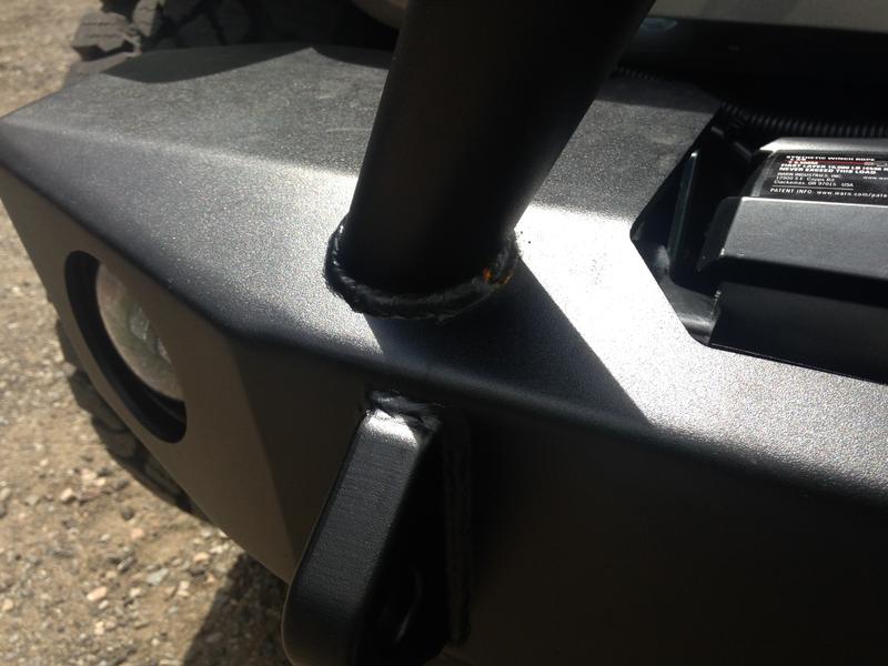

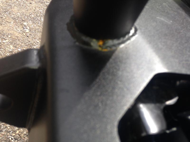

Overal paint finish is not bad but I had a spot near on side of the bull bar that was not properly painted and there was a bit of rust so this is very disappointing for a brand new bumper.
The warn Zeon winch fit very well in this bumper.

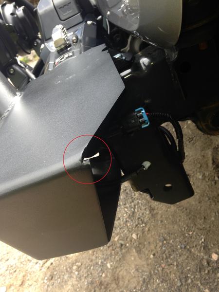

The bumper have not properly built and you can see some flaws in the cutting and grinding on both sides of the bumper, this is unacceptable for a bumper of this price range.
so here is my final impression; the bumper have a great design but finish is not what you should expect for the price sold. I would not buy this bumper again.
I might sound difficult but I don't want to put subpar products on a 40K Wrangler.
This bumper has a great design but should be made with more care and a better quality control.
I would not buy any other products from expedition one also.

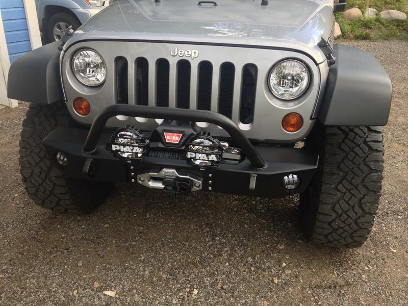

more pics

What PIAA lights did you go with for your front there on the bumper?

What piaa lights did you go with for your front there on the bumper?
piaa lp 560
