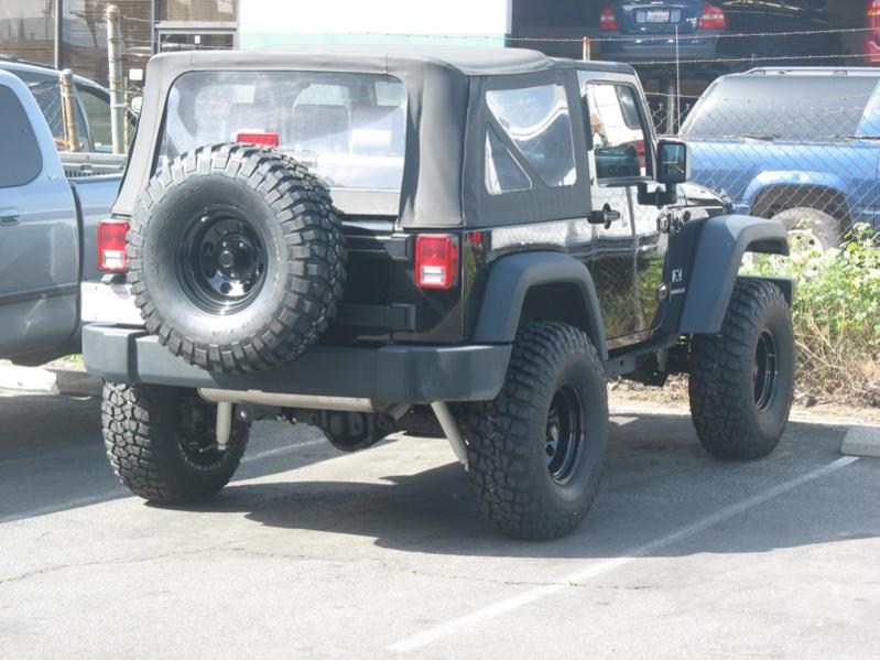

I personally went with a 3.75 offset for a wide stance and to clear my 15in wheels from my brake calipers.
