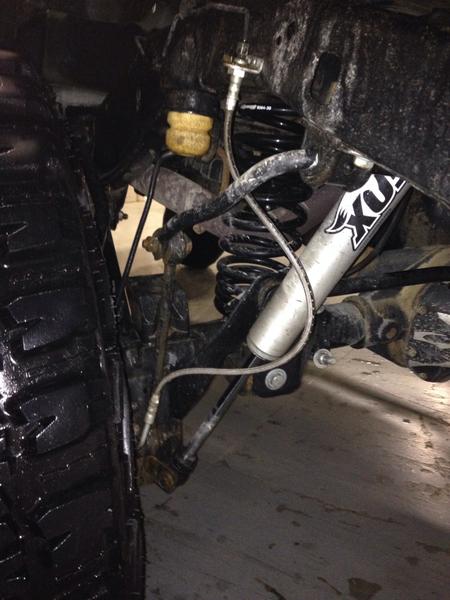

just installed 4-6" longer brake lines last night from Toxic and they have plenty of travel and are great quality.

holy crap dude? Awesome brake line job, but your antis away bar angle??? I hope this a pic of it lifted by the frame. If not, might want to get extended links.
lol...that pic is when we were flex testing it so it is pretty drooped in that pic...the sway bar sits almost level after adding the Synergy springs ....longer links or drop spacers are on the short list!
