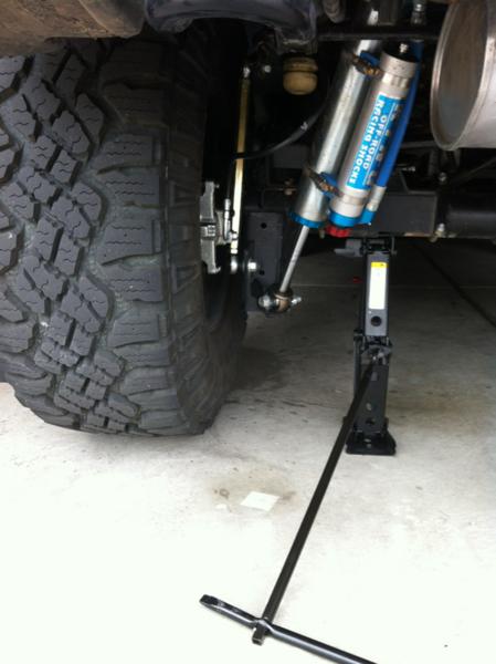

I installed the crown brake lines too. Here is a pic of the rear driver's side (sorry for poor quality it's all I had on my phone).
Edit: FYI--I also rerouted my hard lines up a bit. I felt the sway bar end link bolts were coming too close at full stuff.

Originally Posted by MTG
+1
Attachment 303067
Thanks, that pic actually answers a few questions.
