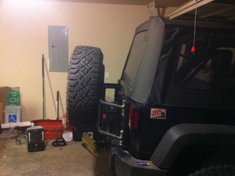

Thanks everyone, and a big thanks to Steve @ OR-Fab for calling me. I resolved my issue last night and have now completed the carrier install.
The gate closes much better. I could still adjust it some more, but that just me being compulsive about it... and at least now I know how to adjust it.
For anyone reading this after the fact...
The big thing for me was understanding which bolts adjust what, and the order to adjust things in.
First thing... Adjust your pre-load first. This will have an effect on your tail gate alignement, so might as well not have to do that twice. The pre-load is fully set using the six bolts on the tub side. For my 35" tire you want (thanks Steve for this tip) to make sure that without any weight it sits about 1/4" too high for the landing block. Once you add weight it should sag down to the correct height.
Second thing... Adjust you tail gate. For the most part, you tailgate is fully adjusted with the four gate side bolts. Assuming you gate lines up enough to close, close your tailgate and loosen the bolts. Once loosened what I had to do was grab the gate handle and yank to the passenger side and down... the tailgate shifted. I then tightened up the four bolts, and the gate seemed much better.
Thanks again to everyone, I wouldn't have been able to understand it so well without your help
