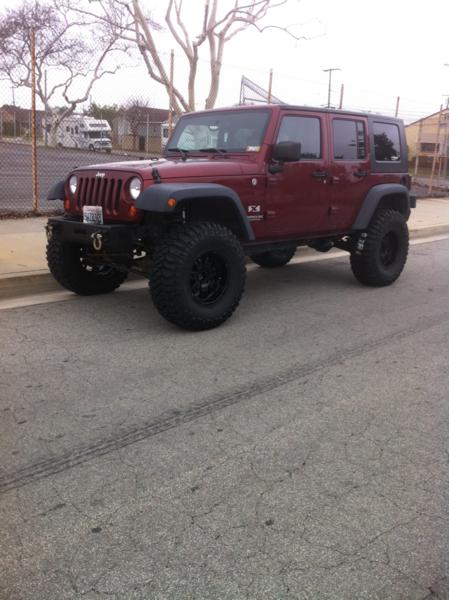

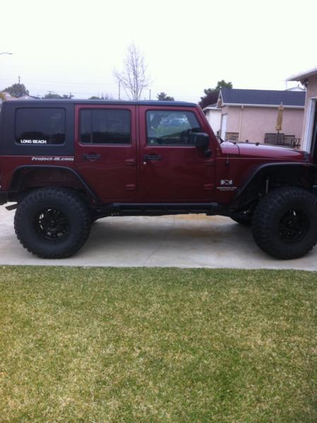

im gonna do it myself to but i can only work on the weekend .hopefully i want run in to much trouble .do u have any pics of yours?
Old Apr 3, 2011 | 12:56 PM
LBJEEPER's Avatar
Joined: Jul 2008
Posts: 320
From: Long Beach, CA
First pic is obviously with stock flares and then after my Evo sliders and Xenon flat flares. You might run into a hiccup or two my advice is don't use the cam bolts, just adjust the links and have a bench vise to put on the heims, would help alot.
