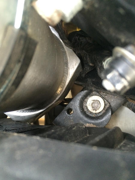

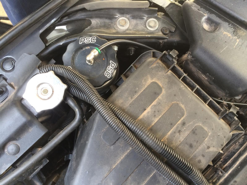

Smashboogie shaved the base of my reservoir and routed the lines around it to keep the factory airbox and aev snorkel. Not sure if they have any pictures of how much they removed. I can try to take some tomorrow.

it's a 16" max. Just got home and the rain stopped I'll go pop the hood
Hose is about 13" long
