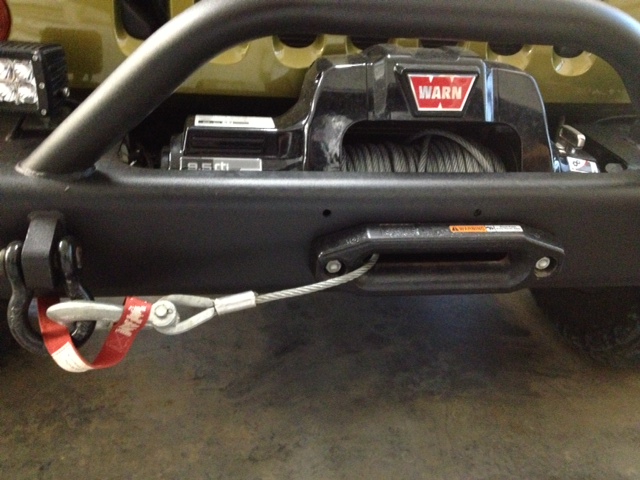

Yes you can run a hawse fairlead with steel cable but it has to be made out of steel not aluminum. I run a steel one from warn
