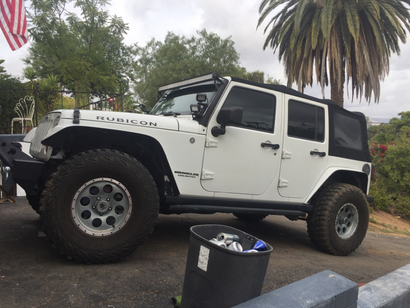

Originally Posted by rfr002
You don't need a lift to run them. If you want to stay liftless here is what is needed: 1. Correct backspacing rims. Numerically less than 4.5". Spacers that are hubcentric are fine. 2. Trimmed pinch seam. Starting in mid-'13 they are trimmed from the factory. May require more, though. 3. Narrowed front bumper. Either aftermarket stubby or trimmed factory. 4. If you carry a fullsized spare, something more robust than the factory carrier. 5. Trimmed or new, high clearance fenders.
Correct!!!! Here's mine. No lift.

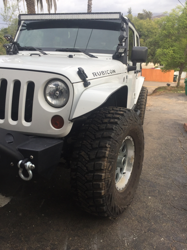

And if u get one with rubicon rails, cut those before you even go to the tire shop. I have 315/75/16 MTRs (true 34" really) and that was the most limiting factor to going up in tire size. Other than that, u will need an AEV procal as well.
