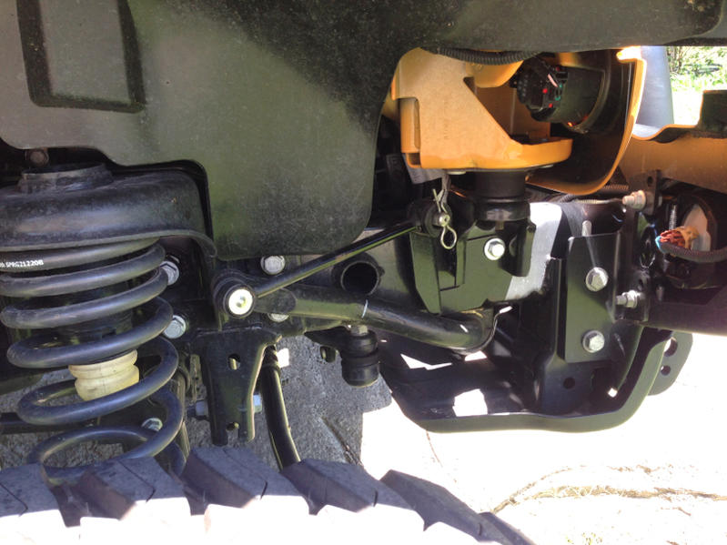

I don't know if you guys have them available but I have the ARB quick disconnects. They work very well and have the ability to swing up and be locked away so that the sway bar doesn't move and snag in the steering or suspension. They are also greasable through a grease zirk on the detachable link (lower)
Btw I am in Australia

great idea on the bracket. Can you get a closer more detailed shot of it . I would like to fabricate something like that. thanks

The Tera Flex disco's mount the same way. The pin bolts to the bottom of the body mount rubber.
