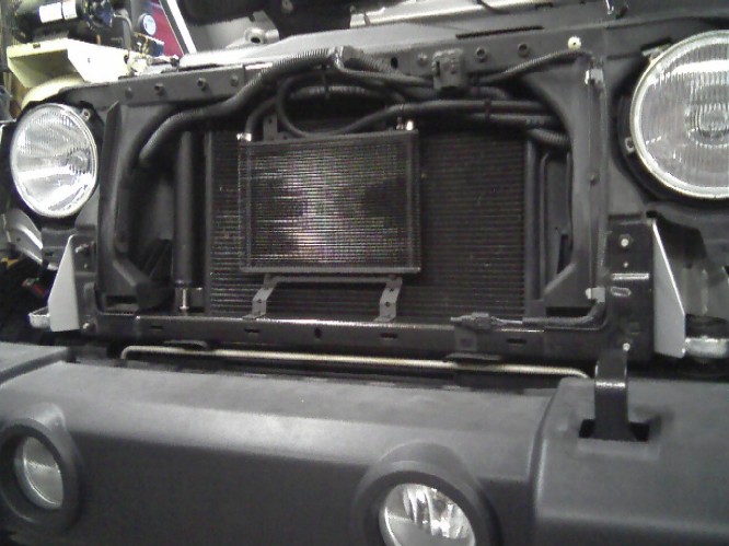

I ordered mine through Summit Racing. The B&M 70268 comes with a length of 3/8" trans cooler line and I bought an additional length from the local auto parts store so I could mount the cooler the way I wanted, inlet and outlet facing upwards (see photo). I didn't do a "Hard Line" install... but I mounted the flexible lines from the cooler directly to the factory hard lines. The nipple you speak of is incorporated into the construction of the Super Cooler, soldered directly to the cooler.
