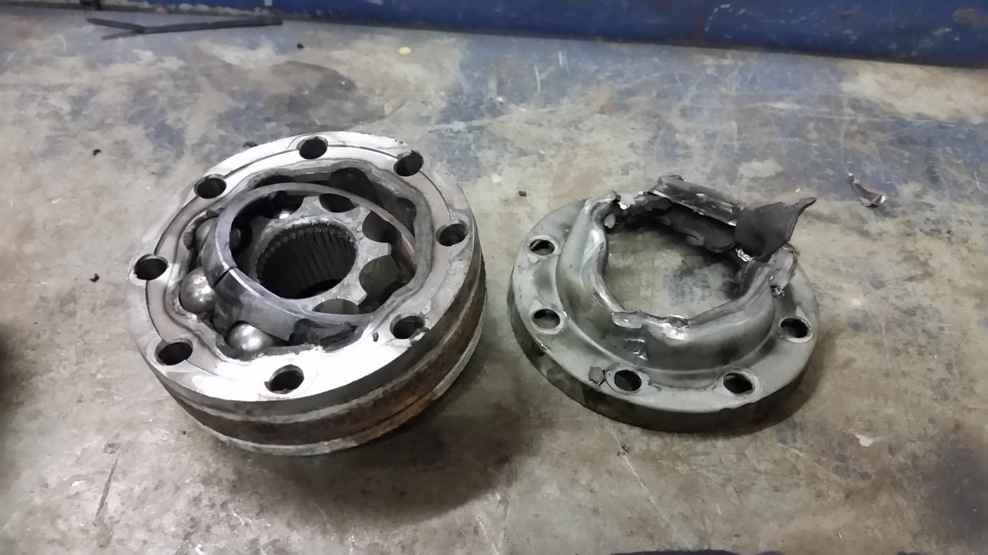

Default Problem Seems To Be Fixed
So my Jeep mechanic checked out the problem and as soon as he looked under it he found the driveshaft sitting on the skid plate? Was so aggravated that I didn't even see it. Well he replaed the CV Joint and no more noise.
Here's a pic, guess it was pretty messed up.

They can just replace the CV joint on these shafts?
