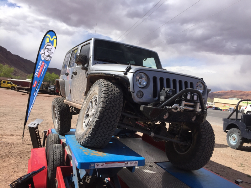

ID:	644756 Because I have 37" tires and want to keep center of gravity as low as possible for rock crawling. I don't play mud so have no use for large fender flares. A picture is worth a thousand words. Flat fenders gives me extra up travel clearance over factory fenders. Which in my opinion also look horrible. This is the actual purpose however a lot of guys do it just for looks. Depends on the person and the purpose.

So are you saying they can be a problem when the suspension flexes and the tires might hit the flare?

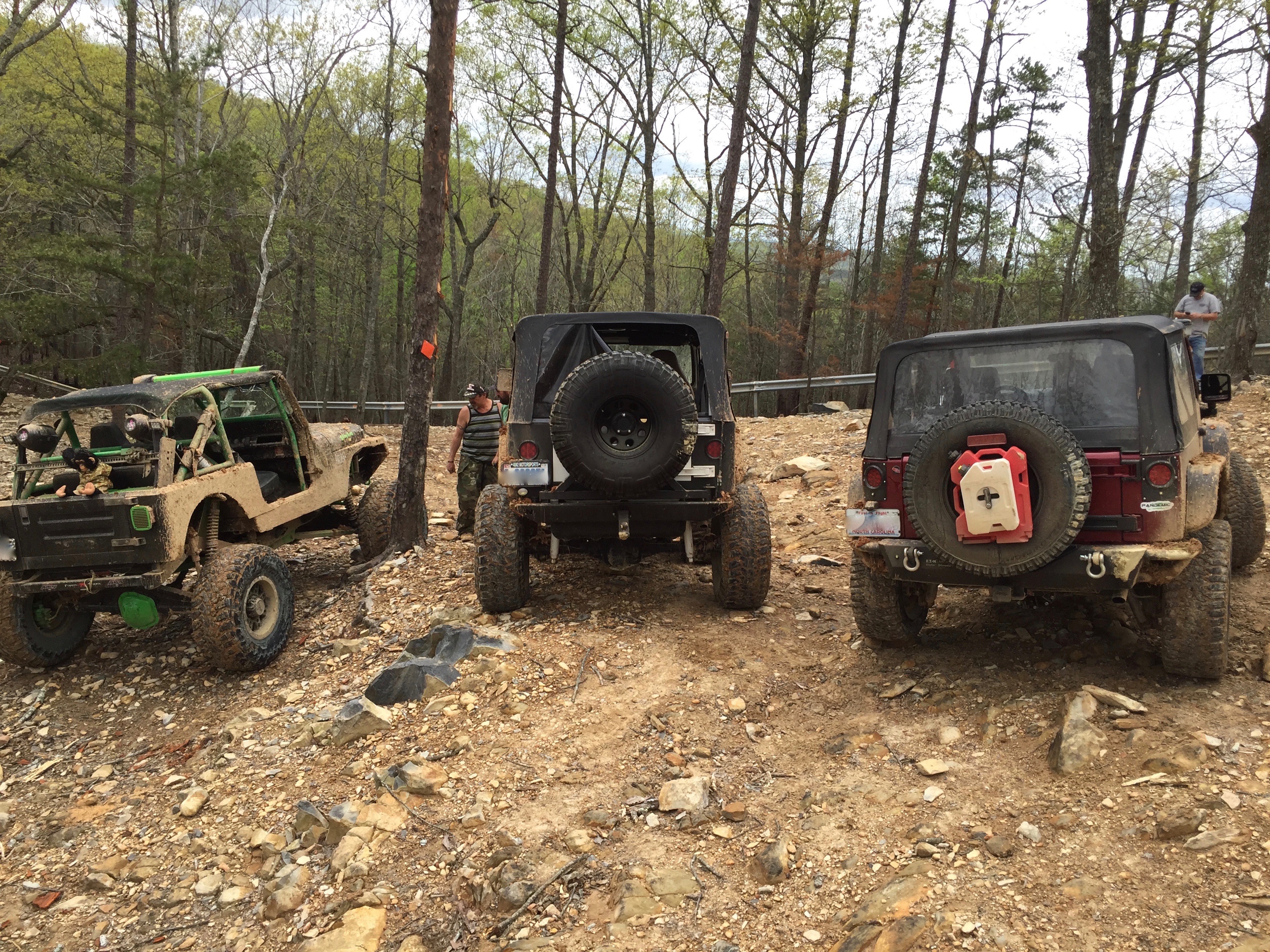

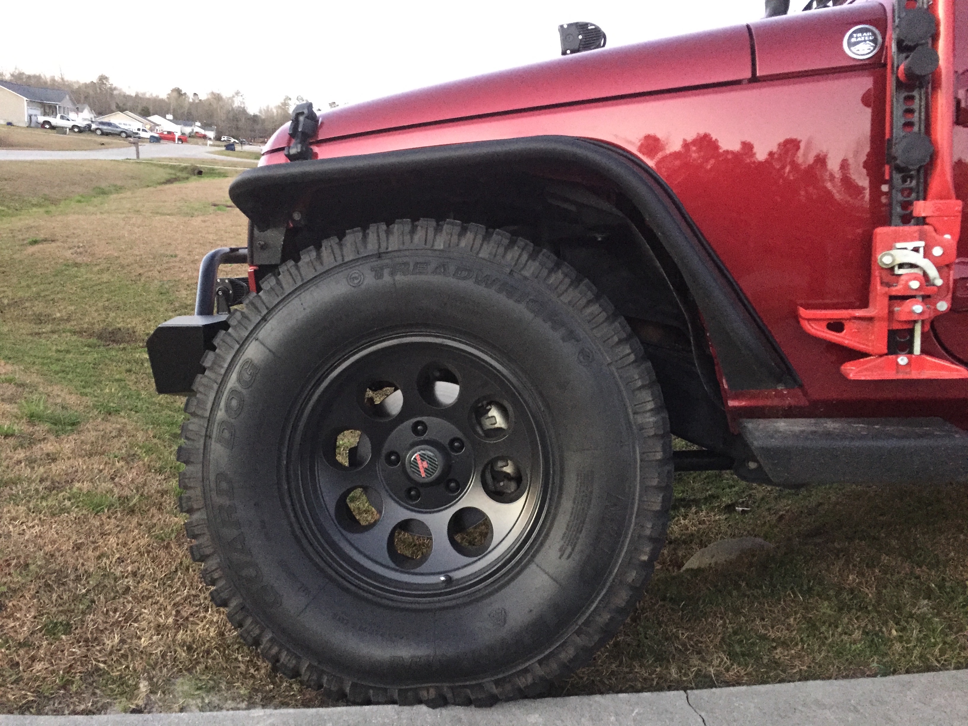

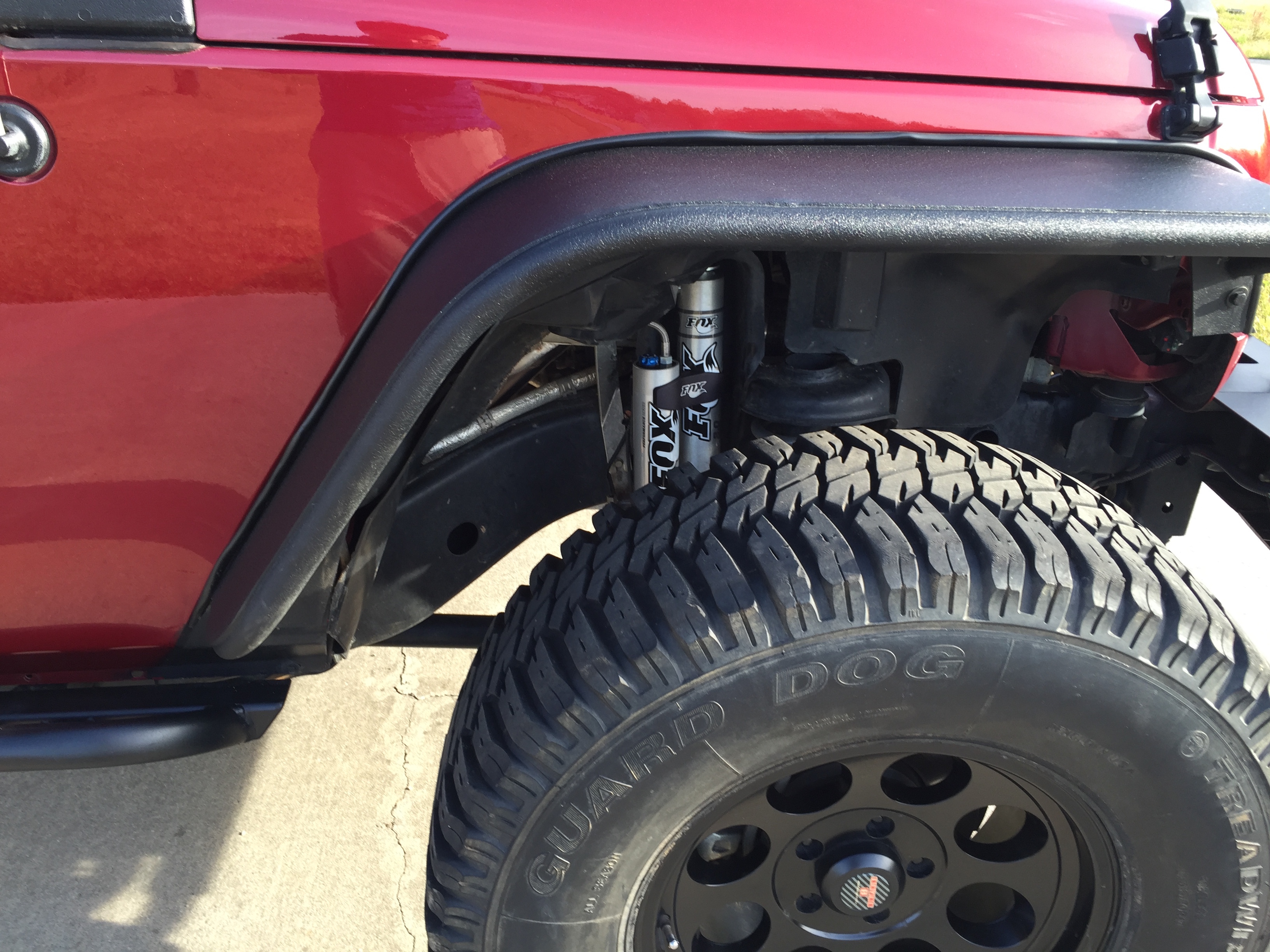

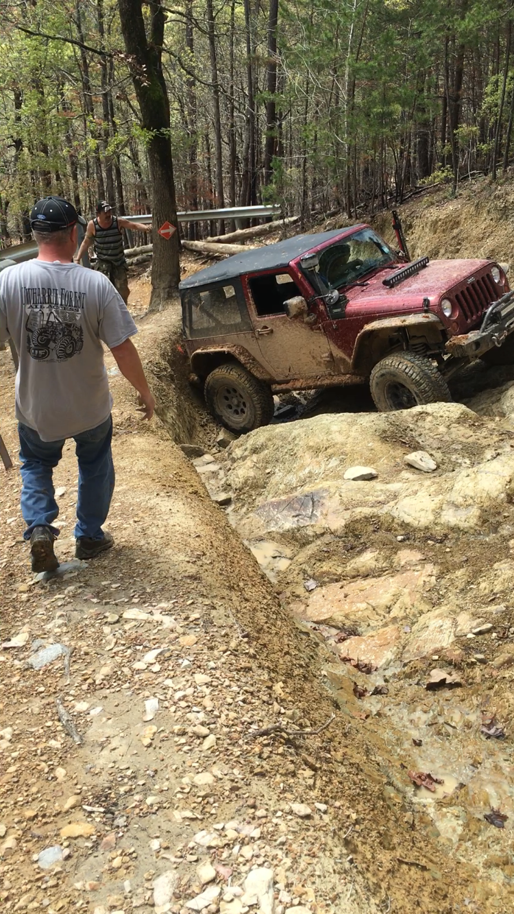

Your going to have to check your state laws about fenders. I know a lot of North East states like NY, MA, NH etc... have laws against tires sticking out of the fenders some even go as far as requiring you to have mud flaps I think thats in Canada. North Carolina on the other hand does not require fenders at all. Shoot If I could get away with it I would have ran mine without front quarter panels but my wife would have killed me.
*Edit* Here is another picture 1 out of 3 Jeeps had Fenders. Yes I had Fenders I'm the odd man out.

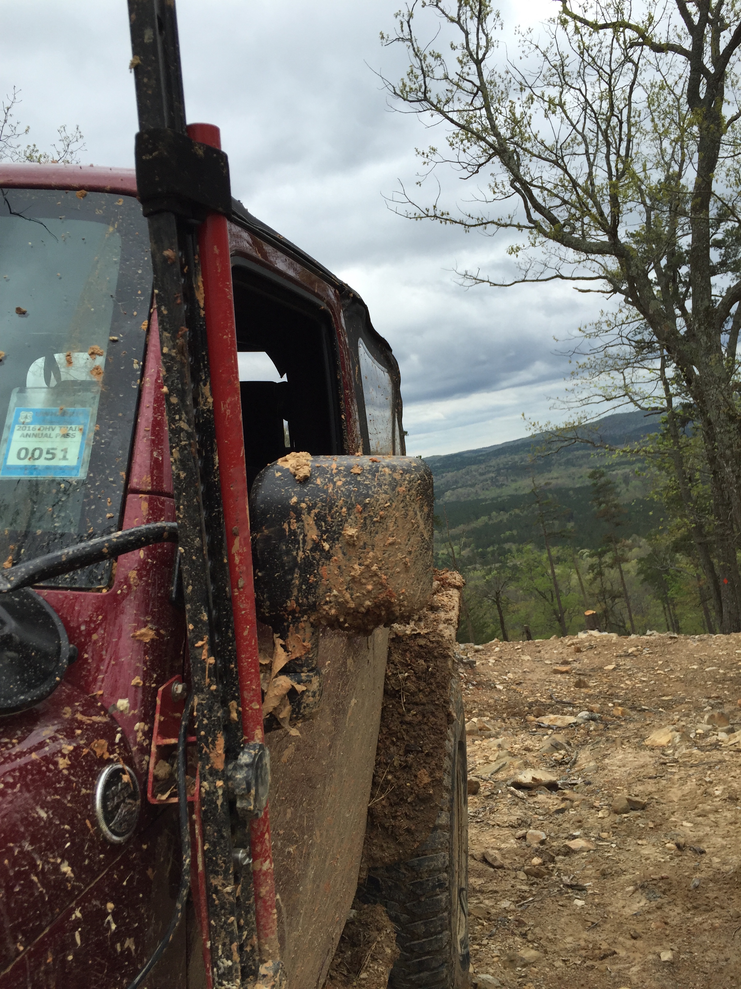

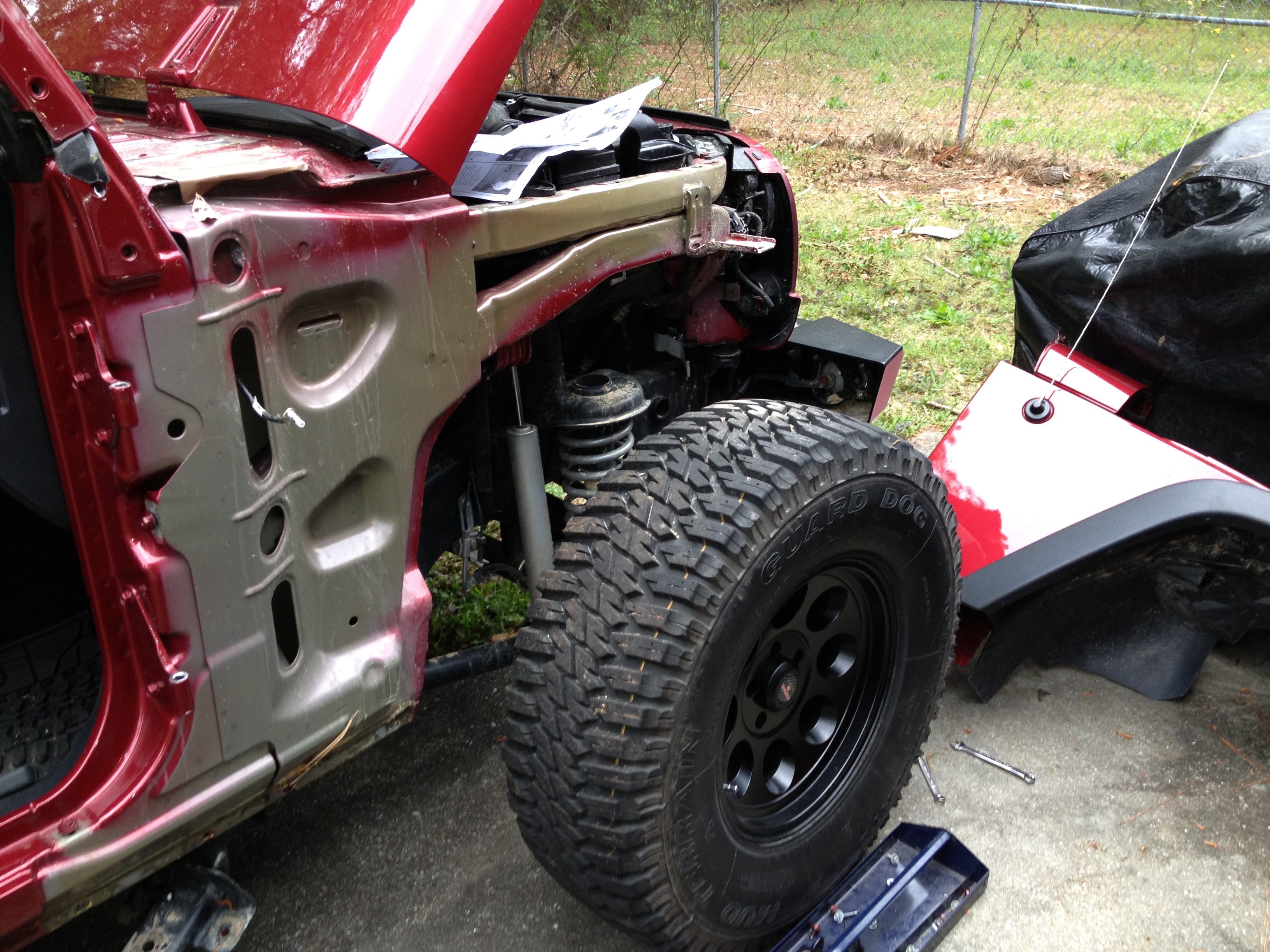

Yes Flat fenders are like shelfs for mud, so are Rock sliders with steps. Yes mud sucks. Actually aI had more mud on my Jeep than the guys that did not have fenders.
