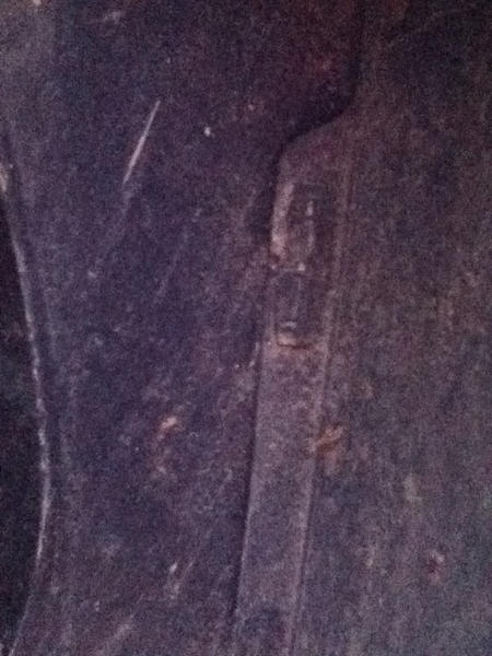

Ok guys so I'm sure this has been asked many times but I can't find it. I'm on my iPod so the search is basically useless.. I have also read through many pages if reds fender trim. Basically my only question is how to remove to clips that hold the fenders to the body?

Only instructions I've seen on pulling those off is to take all the other bolts underneath off then the fenders are just hanging there just give it a good tug it will come off I did this
Do they go back in fine?

Some of them will break and have to be replaced. I've seen people mention on here where online you can buy those clips really cheap. Jeep/mopar would want like 10 bucks a clip. But even if you remove each one individually they can still break. Jeepswag.com may have them in a bundle or north ridge.
Thanks for the heads up. And it seems that just yanking them out is the only way?

I just replaced my fenders and almost every single clip broke. My jeep is a 08 so they have been on for awhile. I would just count on replacing them
