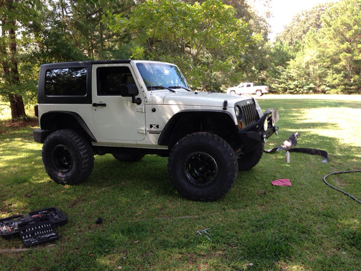

I have the Bushwacker flat fenders and thought same thing but man they r tuff. Surprisingly super strong after install and you do keep your inner fender liners just gotta trim. Install took me about 4 hours front and back but well worth it. No experience with metal fenders but just my two cents. Good luck

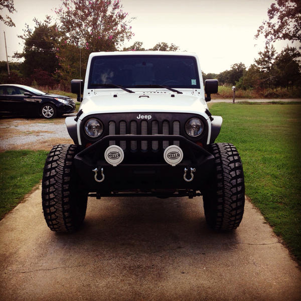

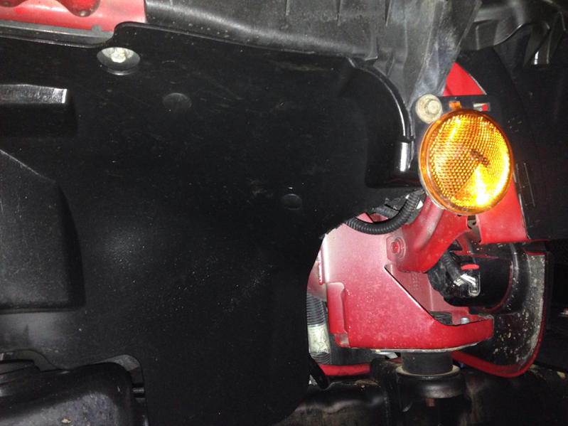

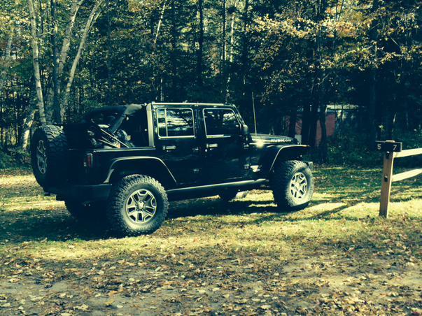

I had the smittybilt on my last jk. They looked great and was built great. For the inners I cut the front and reused them. For the back I bed lined the fender wheel. For the marker light you can trim it and relocate it
