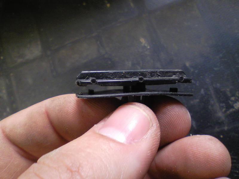

i just had my fenders off to trace the mounting plate for tube fenders thought i would post some pics of the clips that hold the fender to the body . little tip pull on the bottom of the fender near the bottom of the door and work your way around to the front then remove the clips
ID:	315086Click image for larger version
ID:	315088Click image for larger version
